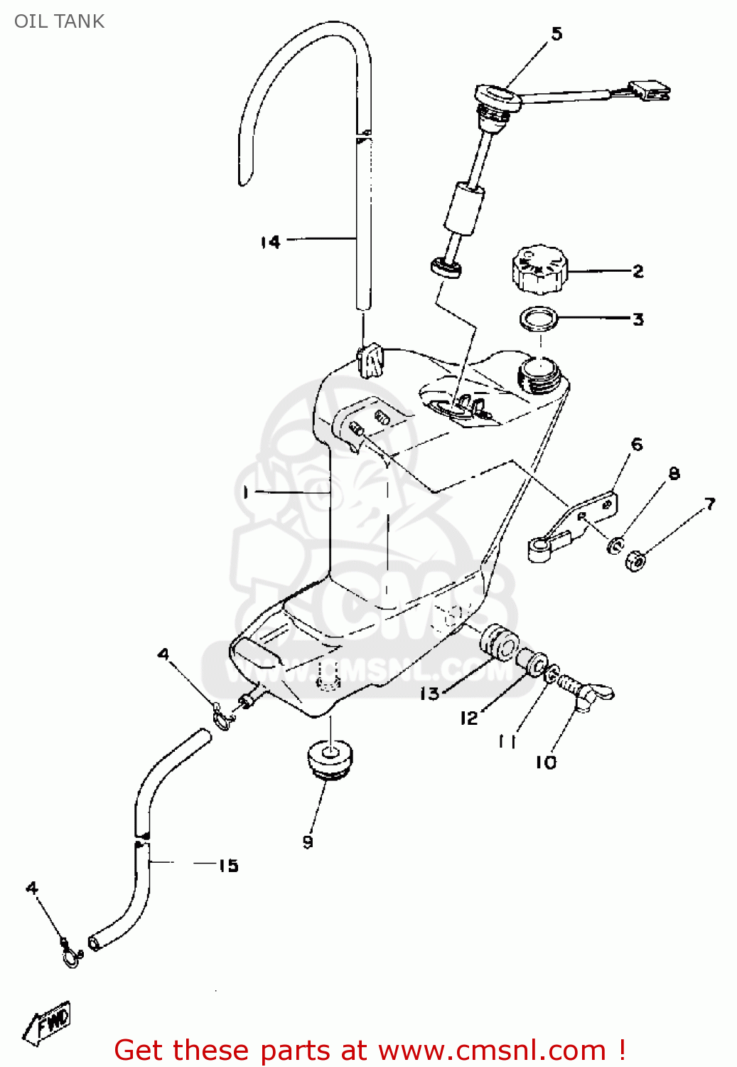

Here is a link to the 1979 oil tank diagram. I doubt it changed much by 1982 as the 250/400 models seemed to be taking their last breath after they were banned for sale in the US. You can see the wing bolt at the lower right of the tank.
images.cmsnl.com/img/partslists/yamaha-d...yau1121d-10_408f.gif

Ah, thanks that is exactly the oil tank that I see. Thanks for merging the post - reason I "broke off" was because the original thread was for suggestions for servicing, etc. But I'm stuck on this specific issue so I thought I start a new thread just for this issue. With hindsight I can now see how expanding the original post might have been better, rather than start a new one.
