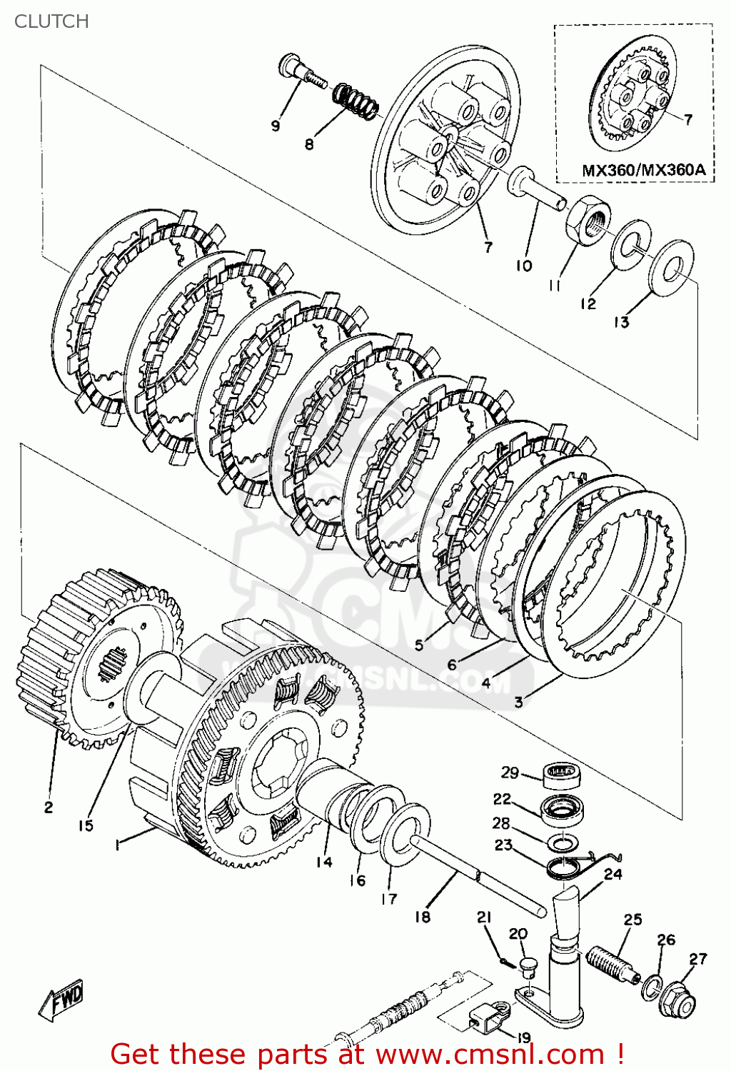

I recently tore the engine down for my 74 MX250 and i noticed that there is no bearing where the clutch arm slides into the case underneath? I know the enduro models have the bearing. My friend who is familiar with the MX models says the MX doesn't have it. The diagram does show that its in there but we all know diagrams can be a little off sometimes. Im wondering if anyone can confirm weather or not it should have the bearing or not? im thinking no, im not seeing any evidence of one that was removed but who knows whats happened with this bike over the years.

It's got to have one. When you remove the arm with spring & washer you should see the seal then the bearing.
Drawing is maybe slightly confusing as makes it look like its at the top end but isn't.
It's a wonder it not leaking oil badly as would try to move sideways & pull the seal open during clutch actuating.
You could make a brass bush i guess or even an alloy bush, better than nothing.

I have replaced that bearing on 3 of the enduro models both 250 and 360. First time restoring an MX. When i removed the clutch arm and seal there was no bearing up inside. I just find it hard to believe they would not have one there so someone must have removed despite how clean it looks inside. I see it in the diagrams but i never fully trust the diagrams.

In my post I see I said “it’s got to have one”. I didn’t mean it had to be there & keep looking. I just meant if it’s not there then yep it needs one.
