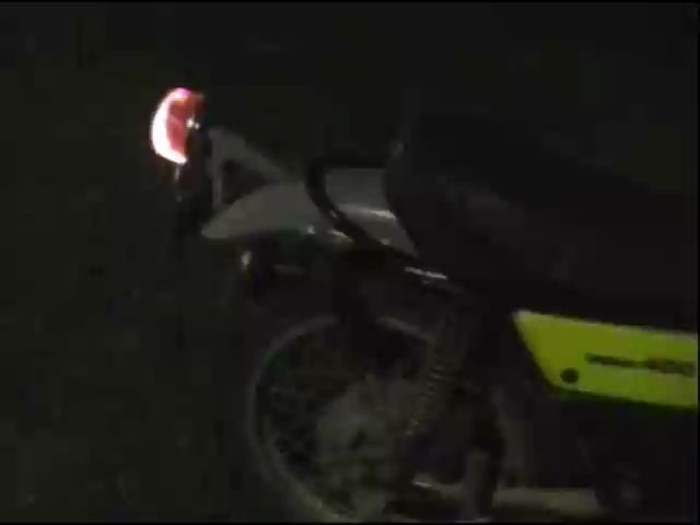

to wire in the Powerdynamo system. I took the red wire from the regulator/rectifier and hooked it to the yellow wire and the white wire.
I connected the white wire to the red wire from the bike together.
the red wire from the bike goes to the key switch and it connects the red wire to the brown wire. this is the switched power for the accessories like the horn,brake light, possibly tail light and turn signals.
I need to get the accessories before I can test this and see how it works.
the headlight,instrument illumination and high beam indicator work beautiful.
the Powerdynamo has no trouble powering a 12 volt 60/55 watt H4 headlight.

I welded on the Stinger to how it would had been on a stock Hooker pipe. the pipe now has room to open the seat latch whereas the seat latch handle needed to be modified to clear the stock Hooker stinger. the OD on this 1 1/4" pipe is not as big and does not require the latch handle to be trimmed.
I plan on adding a elbow with another length of 1 1/4" tubing to mount the silencer.
here is a pic of this pipe mounted on my other DT400.
here is a video with the Hooker pipe on a stock DT400.

here is another video I uploaded on Youtube. I went a little easier on it in this video and the bike never missed a lick until I stalled it but it lit right off with no trouble.
the compression release cleanup work was a complete success. it feels like you are kicking over a 80 or 100 cc two stroke,almost too easy!
I also found out the other day that the clutch is really slipping very very little. I got it up on the ports the other day with it in 3rd gear and it broke the rear tire loose violently, so much so the bike actually fish tailed a bit! when I get some tires on it that will hook up, it will then be really interesting!
